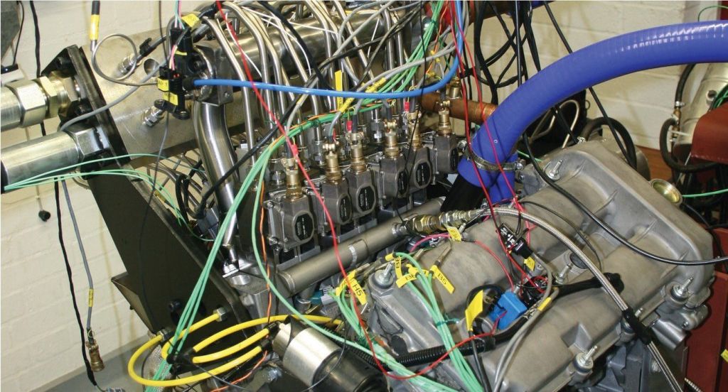

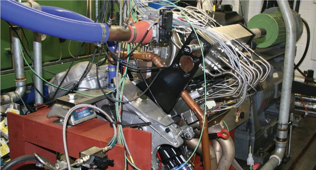

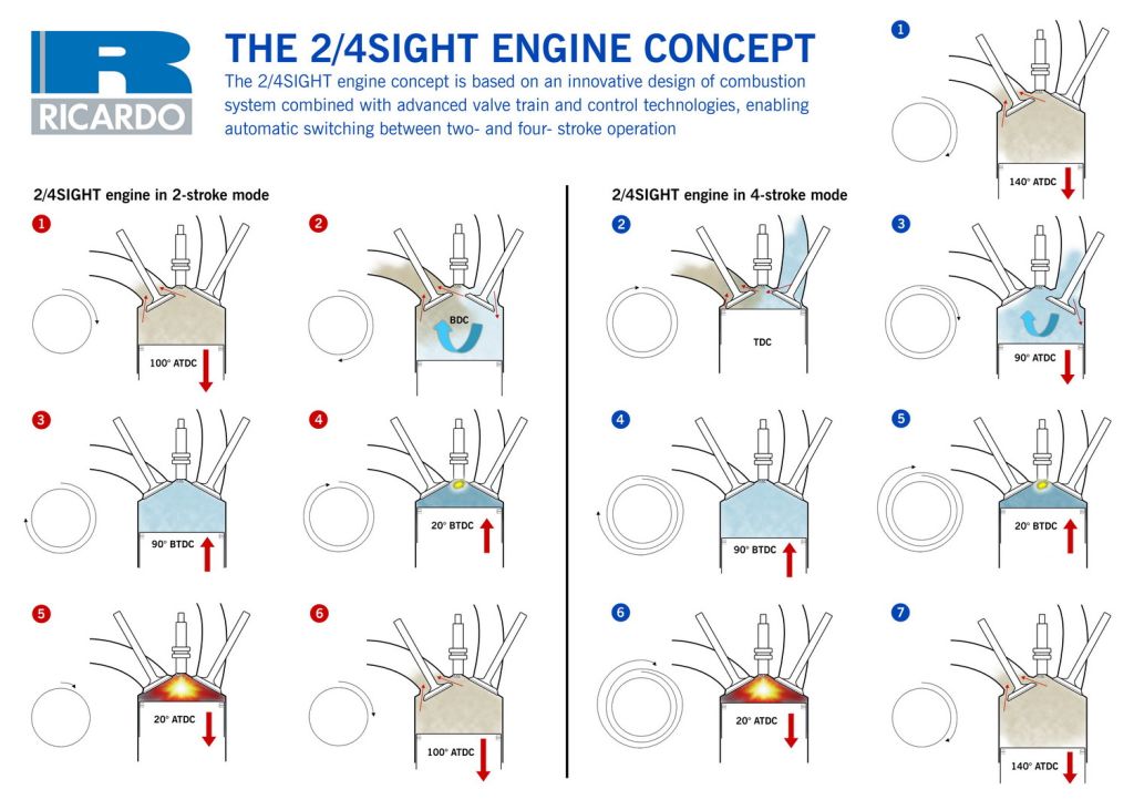

Prototype 2-&-4-stroke 2.1L V6 Engine Promises 27% Fuel Savings Over an a 3.5L V6 with Equivalent Output
In collaboration with a series of automotive partners that include DENSO, Ma 2T4 and the Universities of Brunel and Brighton, Ricardo today announced the completion of an advanced prototype gasoline engine concept called 2/4SIGHT. This innovative engine utilizes a series of solutions to enable automatic switching between two- and four-stroke operations, with the aim of combining significant fuel economy improvements with high-performance.
The research prototype engine is a 2.1 litre V6 unit that uses a direct injection gasoline combustion system in which the design of intake and exhaust ports, combined with appropriate changes in boost supply, fuel injection, ignition and valve timing, enable it to work both in two-stroke and four-stroke modes.
An advanced control system coupled with flexible valve actuation manages driver demands and coordinates operation of the boost system, valves and fuel injection equipment at an individual cylinder level. Ricardo supports that this enables smooth transitions between two- and four-stroke operation without torque interruption in both transient and constant torque conditions. -Continued after the jump
Ricardo carried out a vehicle drive cycle and acceleration performance simulation using an 1800 kg passenger car sold in the European market equipped with a 3.5-litre naturally aspirated V6 gasoline engine matted to a 5-speed conventional automatic transmission as a baseline.
The company’s simulation results indicated that while the 2/4SIGHT gasoline engine could maintain the same acceleration figures - including launch from rest - with the 3.5 litre powerplant, the prototype unit deliver fuel savings of 27% over the New European Drive Cycle (NEDC) while CO2 emissions where reduced from 260 g/km to 190 g/km compared to the same vehicle equipped with the conventional 3.5L V6.

a me par na stronzata un 2 tempi con le valvole....proprio non riesco a capirne il funzionamento,non riesco a capire per lo meno,come questo possa rendere potenza.

visto che sono ignorante e che ho bisogno dei disegnini
vi ricordate quel sito web che aveva tutte le gif animate dei vari tipi di motore? non ho l'indiriss
riesci a sfruttare di più l'espanzione del gas mettendo le valvole al posto delle luci , che pur essendo colcolate e precise , sono sempre un rimedio approssimativo IMHO Grin
non hai rendimento volumetrico in questo modo,perchè è più l'incombusto che ti rimane della miscela che ti entra.e a meno di un complicato quanto voluminoso sistema,non puoi sfruttare lo scarico a coni.
le luci non sono un rimedio approssimativo,sono semplicemente essenziali per avere il massimo da un 2 tempi.
   Re: 2 o 4 tempi ?   Vai Giù Vai Su Le News Indice del forum
Marzo 27, 2008, 00:29:53 am
carini i disegnini,ma di fatto inesatti,van bene forse per il corso di scuola guida. Grin
il 4 tempi non ha incrocio,che è ormai prerogativa di qualunque motore,in maggior misura per gli aspirati che girano alti.
il 2 tempi con ammissione a valvola dev'essere roba navale,o per motori di qualche secolo fa.quelli con ammissione lamellare o a valvola,con espansione,sono parecchio differenti.
l'atkinson se non ricordo male,è famoso perchè la valvola di aspirazione chiude quando il pistone sta risalendo,non è rappresentato questo.
