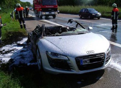

Pare che a scatenare l'incendio sia stato un guasto del cambio automatico R-Tronic:
"The car burned has been a test car, serial no. below 1610.
All cars below this no had problems with the R-Tronic and the fire was caused by a hydraulic failure.
Most of the cars with a serial no below 1610 have been test cars. It has been a simple software update for the gear box hydraulic system to eliminate the problem.
So don't worry guys it's been solved. My car has been delivered know one month a go an the serial no is above 1700. All the other owners have received a software update. The car of the Audi deal which burned just hasn't being updated. Well guess it would have been easier if they would have done it."
