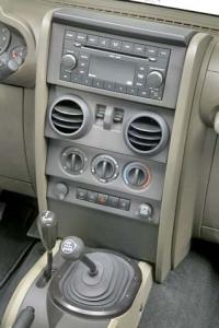

Manufacturers have done a lot of crazy, tacky, tasteless stuff to truck and SUV interiors in the last few years. Happily, we can report that the new Wrangler did not succumb to wretched design excess. Oh, it?s plenty different, but nothing to turn away loyal fans.
The Wrangler lost a lot of its rugged charm when the TJ hit the scene, and the new TK has taken refinement to the next level. There?s a definite contemporary SUV flavor to the dash and instrument panel, but nothing to cry ?Foul!? over. It?s cleaner and sleeker, yet holds close to the pattern established with the TJ. Where it diverges most from its predecessor may be the door panels. They certainly exude more character than anything that has come before, however, part of that is functional. For the first time in a Wrangler, power windows and door locks are available.
The only thing we can say that looks kind of goofy is the dash-mounted tweeter speakers. They sit upright near the A-pillars, and kind of look?well?odd. It?s obviously a great position to enhance the vehicle?s sound stage, but? And speaking of audio, all radios are MP3 compatible thanks to an auxiliary jack located on the radio faceplate.

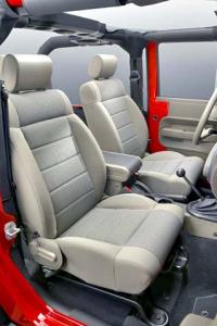

Dimensionally, the new Wrangler is more accommodating than the TJ, due in large part to the vehicle?s greater width. Driver and passenger shoulder and hip room is up 5.1 inches and 4.6 inches, respectively, and even backseat passengers benefit from marginal increases in shoulder and hip room, and an inch more leg room.
Another addition we like is the lockable under-floor cargo bin found behind the fold-and-tumble rear seat. Nice place to put a few essentials. As for the center console, it?s been updated with a centrally positioned parking brake handle, lockable storage bin, and front and rear passenger adjustable cup holders. Finally, the driver and passenger seats have a more sculptured, performance flair about them, which should be welcome when the trail gets a bit exciting.
